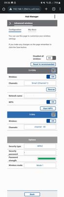

Can you go into your hubs Advanced Settings and post a screen shot from Wireless, obscure your SSID and password before posting, it's safe to leave everything else as is

Will be interesting to see the Wireless shot as @Les-Gibson suggests.
At this point it does look like the SH2 is faulty (unless the screen shot highlights something else), we should not rule out the possibility of 2 (or more) faults, but 3 faulty SH2s does seem very unlikely.

 photo of advanced wireless, I have tried multiple channels and multiple modes.
