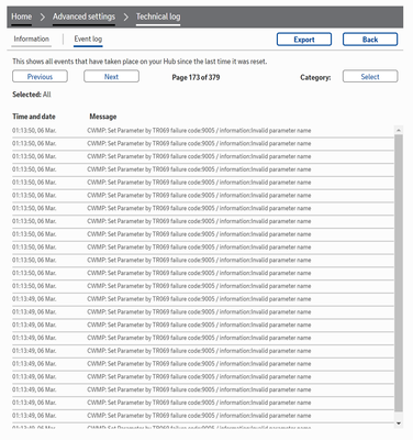

So I ended up going through the log files of the hub and came across this on the 6th March, which is right around when the upload speed got cut in half from 100Mb/s > 50Mb/s~
I assume this relates to the upload speed cap, what also caught my attention is despite having previously done a factory reset from within the settings of the BT Smart Hub 2, the event log went back to May 2023~, when we first got the the BT Smart Hub 2.

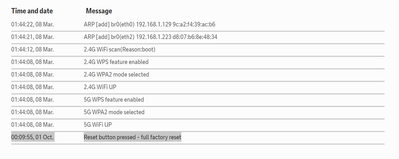

A factory reset will normally erase everything, including any configuration files or event logs, so I decided to try doing a factory reset, using the physical reset button on the BT Smart Hub 2.
This time our event log is much smaller, going from 379 pages to 11 pages.
And in checking the audit log, this is actually what counts as a full reset.

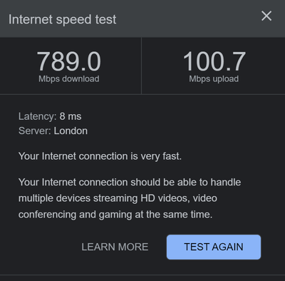

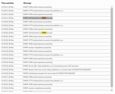

Once everything was synced back up, upload speeds were still capped at 50Mb/s, but I noticed around few minutes later we had a "CWMP: Set Parameter by TR069 Success." message
And after running another speed test, the upload speed is back at 100Mb/s and our download is within the 650-750Mb/s I would expect over the Wi-Fi 6 AP.
So it seems if you have a BT Smart Hub 2 and aren't getting full upload speeds, if you want to quickly get your speeds back, you must do a factory reset using the physical reset button, as opposed to using the reset option in the Smart Hub 2 settings.
