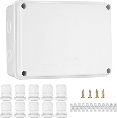

I used to have Wholehome all over which is going to work the same for the purpose of this post, I wanted one outside for my garden for reasons already discussed, what I did was drill through the wall a large enough hole that I could pass an ethernet through and the power jack for the disc, then I got one of those IP boxes: example below...
Drilled through the back of it and passed the power and ethernet inside it, then put the disc inside the box, mounted it to the wall and ensured there was suitable sealant where the cables came through.
I ran a Wholehome disc like this outside for 3 years and it was great, just an idea for you. You can buy AP's rated for outside, I use a couple Unifi Swiss Army Knifes for that now so dont need boxes but the Complete disc is definitely not rated for outside 🙂
