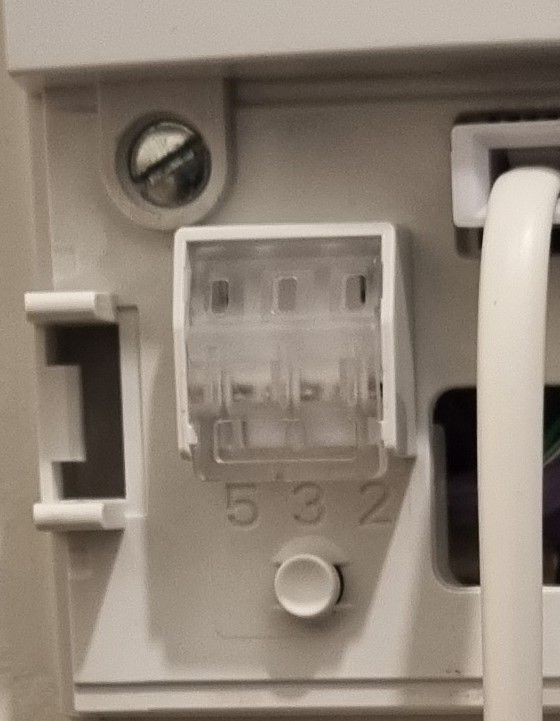

I've just moved into a new place. The broadband master socket (master socket 5c) is located in a cupboard near the door. The flat has 2 other phone points in the bedroom and lounge, but the router only works in the master socket. Is this something that can easily be rectified as having a router in a cupboard is not very practical. I have tried connecting the router to the other socket and it just flashes pink, but connects when connected to master.

Master socket 5c will have a filtered faceplate hence the extensions will be filtered. Move the 2 wires that are connected to terminals 2&5 to the data extension terminals.

I've assumed you have Digital Voice. If you still have an analogue voice service, you will still need the filter at the extension if you move the wires to the data extension terminals and use a phone at the extensions.

Is this part of the thing you are referrring too ?

If that is your master socket then your extension wiring should be connected to terminals 2&5.  Is it the filter that is connected to test socket and the wire is part of filter?

Yes that's just the filter cable so I had Internet whilst it was open
