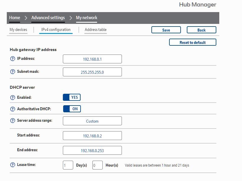

Recently had to replace my smarthub 2 as previous was overheating and stopped the home network.
After installing and setting up the new hub I am able to ping the hub from multiple devices but I cant seem to ping the devices directly between each other.  I found this issue as I wanted to share files across windows file sharing between two machines but windows couldnt see the other machine.
Any suggestions on what might be causing this? I would have thought sharing inside the network was not being blocked. I havent been able to see any other posts about this problem so I suspect its a setup issue on my side.
For information.. My home setup (note the default IP address change)ip address setup.JPG

Assuming that both devices are receiving DHCP from the BT Smart Hub 2 and are not set with static IP information?
If one of them 'is' set static, then check your IP and Subnet Mask to make sure they are in fact correct with the rest of the network. If for example you have 172.16.0.100 with 255.255.255.0 and 172.16.1.100 with 255.255.255.0 they will not talk, as you need /16 (255.255.0.0) so the network ID would be 172.16.x.x and then the rest can be as you wish… I suspect this is superfluous but thought I would add it in just in case.
