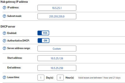

Hi,
I'm trying to setup my network with static IP addresses I have selected a few variations without success.  My most resent attempts were 10.5.25.1 and 172.5.25.1 both with a subnet mask 255.255.255.0 I keep getting the message below.
 - The DHCP start IP address is not valid.
I cannot find a list or range of valid IP address.  I have a BT smart Hub 2.  Please can somebody help?
Thank you,
Phil

It's not entirely clear, at least to me, what you're trying to achieve.
The Hub has a gateway of 192.168.1.254 & the DHCP pool starts at 192.168.1.64 (I think!). So if you want to assign static addresses to devices, they need to be in the range of 192.168.1.1 - 63.
If you're trying to change the gateway address of the Hub then maybe you need to also change the DHCP pool to match. I don't use a Hub so no idea if it can pick up the DHCP range from the gateway or if it needs to be configured manually.
Edit
As @licquorice said, the address chosen also needs to be within the privates ranges or you risk conflicting with an external device somewhere on the WWW. Again I don't know if the Hub is smart enough to refuse to save a non-private address.
16,079 Views
Message 6 of 15
Re: Changing IP Address
Go to solution
As said, you need to set Gateway address for the hub , DHCP pool start and finish range and then set static addresses on devices outside of that range.
As far as I'm aware, you can use any schema on the SH2 within the Class A,B or C ranges.
