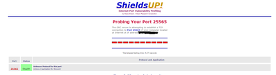

@lazzy_77 wrote:
All my ports are on Stealth mode as seen in the GRC screenshot, can this be the problem?
The ports in the screenshot are only the first 1056 ports and are irrelevant to your problem and as expected. You need to specifically test your port.

After factory resetting the router, I can join on from my pc using local ipv4 address then using the :25565. However a couple things have happened:
- My public ip address changed
- Checking canyouseeme.org port 25565 on the new public ip address says error still
- Checking GRC the port is still on Stealth
I know no way of connecting to the server/ip address from my phone as Minecraft Java edition is only for PC
Yes, it will do, you have a dynamic public IP address and it will change every time you get a disconnection.
Then the port hasn't been forwarded successfully or it would show as either Open (if working) or closed if no service running on the port. I have tested port 25565 and I get Stealth with no port forwarding but Closed if I forward the port without a server listening on that port. I get Open on port 80 with a web server running.
