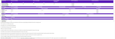

can you enter your phone number or address and post results including the notes which are attached.  this will show what is available and how fibre is likely to be installed
how does your existing phone line enter your home - underground or OH from pole?
