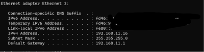

Problem is that my laptop still gets a ULA address:
The problem seems to be on the LAN side of things...

Finally got there. Solutions were:
- WAN1 was set on PPoA => Moved to PPoE
- WAN1 / Internet Access / IPv6 => Enabled RPIng
- LAN / General Setup => SLAAC & 0-Bit
- DHCPv6 Enabled & Prefix Delegation Disabled
- Advanced Settings: RAC Enabled (Default values) and RPIng enabled
Et voila
