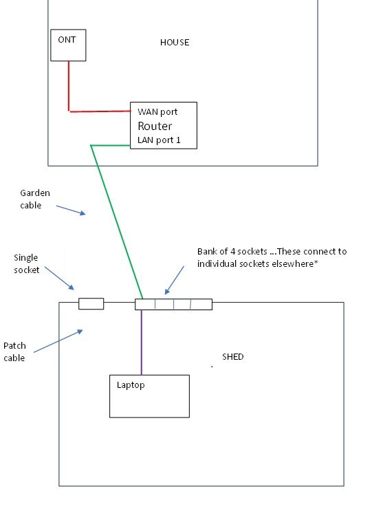

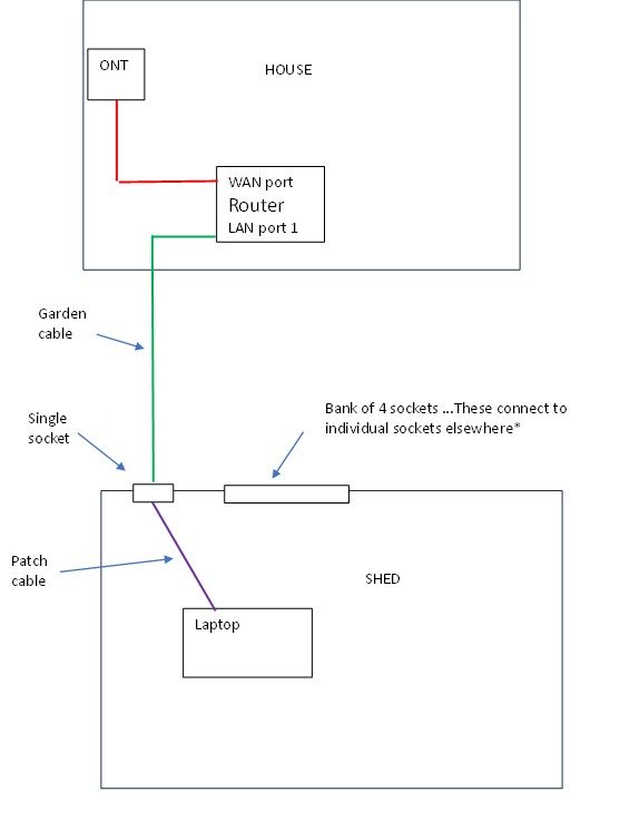

So what you have at the moment is this:
This should work.  If it does not either the green cable or the purple cable is faulty.
*To use these the purple cable would need to go from the single socket to a port on a switch.  Four more cables then need to connect from the other switch ports to the bank of four sockets.

What we mean is he might have done something like this:
