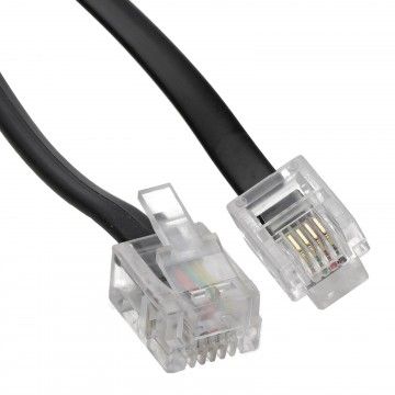

This is an image of the plug from my phone.  But this is the wrong shape and size to fit in the new master socket telephone port.  The port is bigger.  This one half of the problem that I can't figure out.
Also apologies, as after spending a lot of time looking at this online I realise I may not be using the correct terminology.  SO I'll revert to sharing images rather than risk describing the parts incorrectly.

It sounds like you have the cables mixed up between your phone and router.
The router should be the same small square dsl plug both ends and plugs in to the left on the socket,(little router pictured,  your phone may have a square plug one end to plug in to the phone base, and should be a flatter PSTN plug the other (clip on one side) OR you are missing an adaptor.

I changed the socket as it stopped working when we plugged everything back in after unplugging to do some decorating.  I saw online that there's a filter in the old socket and that may have stopped working.  SO swapped to a new master socket.  I have a feeling of embarrassing dread now as I wonder if my wife reconnected the cables to the phone and router the wrong way round.  DO you know if the image above is the correct type of plug that you'd find at the end of the phone cable?

Typically a DSL cable is as shown above by @tonysmini018, RJ11 both ends.
A UK telephone cable typically has an RJ11 one end that plugs into the phone & a BT431 the other that plugs into the master socket.
So if the cables were removed from the devices, which both have RJ11 sockets, it's entirely possible to mix them up.
