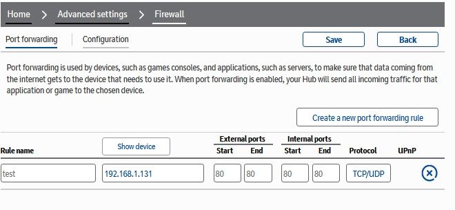

I don't understand that. You can create a port forwarding rule to an IP address without the hub knowing the device.
The rule may not work, but that is the next problem if so.
I have just created a rule to a random IP address that doesn't even exist on my network.

Thanks for your help, I was looking for the IP address to link the rule to that IP address. I didn't release you could write a rule without the router seeing the IP address.
I have written the rule, tested & it works 😊 👍
