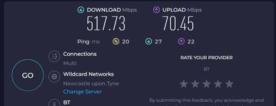

It turns out the cable between the two switches was the issue. I don't understand why. With a new, good quality, Cat6 cable everything is working perfectly. I'm seeing my full speed (plus more) on my PC, which is the furthest away wired device. All good!
