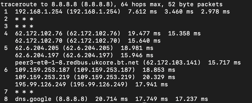

@countrypaultraceroute to a valid address shows what would be expected, i.e. various routers in BT's UK core and then the destination.  Interestingly, none of my traceroute attempts show a response from a BRAS at 172.x.x.x that others have seen, but I'm not sure what (if anything) to make from that.

Not sure if this is relevant or just me reading too much into things. @ptrduffy  not only do you not show a 172 ip address for a BRAS, but you seem to be connecting via routers with  62.x.x.x address whereas it appears that the op and myself connect via 31.x.x.x router. Perhaps different sections of BT customers are configured differently depending on location? I am in the Yorkshire dales if relevant.

@countrypaul  - I'm in Glasgow, so a different part of the country from you.  Regarding BT updating hub firmware etc, I believe they are using TR-069 which was designed for that purpose (and I can see TR69 messages in my hub's event log).  That definitely requires a configuration server somewhere in the BT network, so I guess the .201.15 device could be that in some cases.
Thinking about this a bit more, I'd be really surprised at BT using anything in the 192.168.x.y range for any purpose - technically, I could set my home network to use the 192.168.201.y range, which would totally destroy any attempt by BT to use that address range for something else.  (I haven't checked to see if the hub prevents this allocation, as I'm not that curious 😁.)
