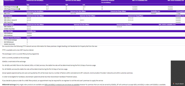

You need to see what is available to first so enter your address and post results

Hope this is ok

Looking at your results it states that the fibre will be fed to your property from overhead from the rear of the property.
It will usually be brought in side near where it's fed to the property but you can speak to the engineer when they arrive to see where the ONT will be placed within reason. They may need to run more fibre externally to where it's then brought inside but maybe limited due to nature of property

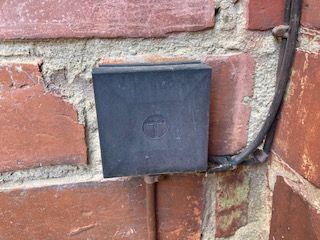

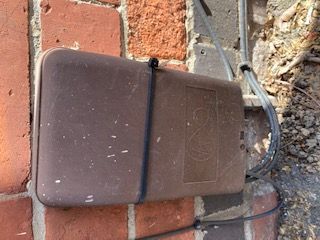

I've attached a couple of photos of the rear of our property just to confirm that we do have an oh feed at the rear. I think it may be on the second photo just above the drain pipes. I think Virgin wouldn't have been able to use it because of their internet system being different.Back view 1.jpgBack view 2.jpg

The cable from the telegraph pole normally needs to terminate on an external block ( called a CSP ) and then a different cable runs to the location of the ONT from the CSP , the router is then plugged into the ONT .
A typical installation in situations like yours , (and the least hassle install ) would be the cable from the pole attached to the house , probably using the same fixing that the existing unused copper dropwire fixes to , it’s then ran down the wall  (externally) to ground floor level and the CSP fitted on the outside wall , then the second cable runs through the wall into the rear room where the ONT is fitted…the old copper dropwire probably removed at the same time so visually no change , one wire from the pole to house

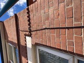

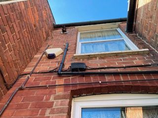

Thank you very much for your reply. I've attached a couple of shots of the front of our property. In the second you may be able to see the wire Virgin installed which runs into our front bedroom. Front view 1.jpgFront view 2.jpg
The router is in the back bedroom which is why we had to have so much cable running through the house.
