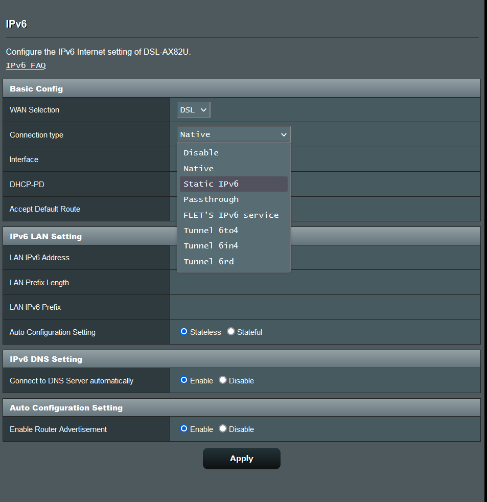

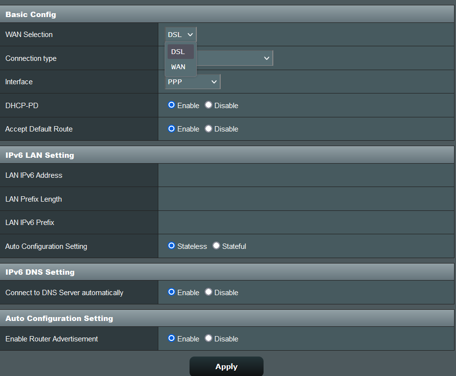

I happened to notice the old modem/router didnt seem to be using IPv6, what leads me to be looking at this configuration page.
maybe something here isnt correct?Screenshot 2024-02-24 153813.pngScreenshot 2024-02-24 153822.pngScreenshot 2024-02-24 153830.png

@Yoced123
Use the wizard selecting the type of service you have and then add in the extras you need like username & password and your wireless settings.

Factory reset first to start with a clean slate.

Before doing any of those, Make sure it has the latest firmware, yes even Asus themselves say to update the firmware first. They know their own equipment better than us:
I will be shot down for saying this, but I'm going to post it anyway:
DSL-AX82U|Modem Routers|ASUS United Kingdom
[Troubleshooting][xDSL] Why can’t my xDSL routers establish an internet connection? | Official Suppo...
Even if the firmware is not intended to fix possible DSL connection issues, there are updates to make IPV6 work more smoothly in there. Routers are one of the important things you always want up to date, for security if not anything else. Strange that this was not suggested here.
So you may as well update before you reset it 😊
