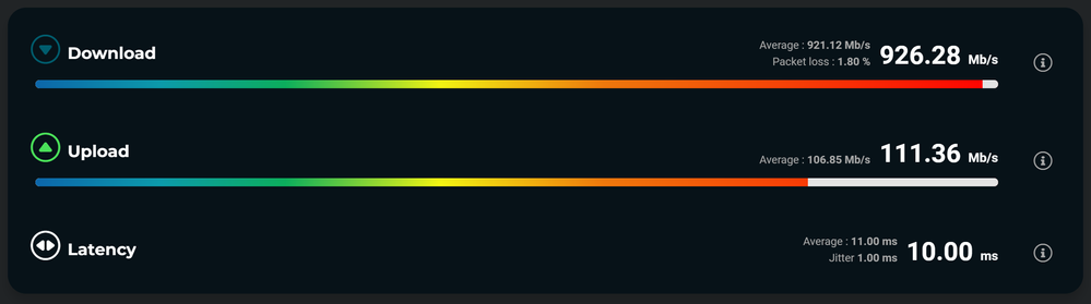

Here's the results when connected via Wi-Fi to the TP-Link AX11000

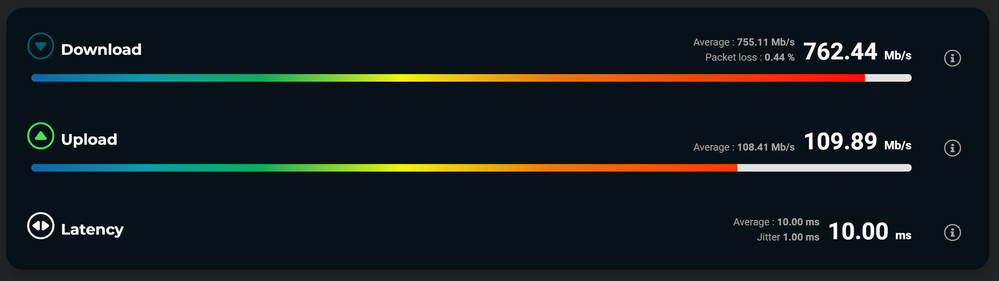

Here's the results when connected via Ethernet to the TP-Link AX11000
And here's the results when connected via Ethernet directly to the BT Smart Hub 2
Depending on the method used, there is between 0.44% and 1.80% packet loss.
If I run a test on https://speed.cloudflare.com/ it doesn't report any packet loss, so I'm inclined to believe this is either a fluke on nperf.com or normal for this type of speed test?
I'd be curious if anyone else has the same packet loss on nperf.com or if this could indicate a problem with the line.
