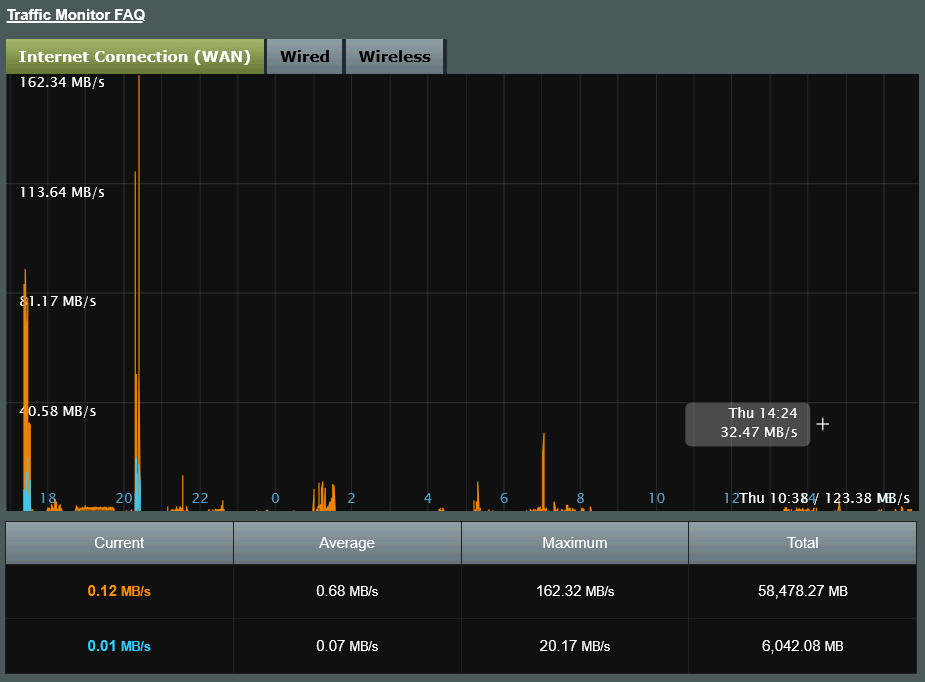

This is my usage for the last 24 hours, if it wasn't for a problem in getting WiFi through a fire wall and door to heating system controllers, I wouldn't need an extender here.
*I'm on FTTP 900, the 1.3Gbps peak is an anomaly that's been around since my neighbour upgraded to 1.6Gbps.
