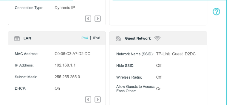

HOWEVER, I did a reset and let the v4 loose on our fibre  connection (Airband, 'cos BT fibre  ain't available here ...)
It auto-configured itself  for  Airband fibre,  and it works !  That suggests that the hardware is ok, and perhaps the v4 setup settings  for VDSL are secret.  I need the BT VDSL as a backup - for when a tractor on the adjacent farm rips out the fibre - as happened last year 😞
Fibre settings  that now work  below.  So  if someone knows the "secret"  settings for BT VDSL, tht should likewise work...
