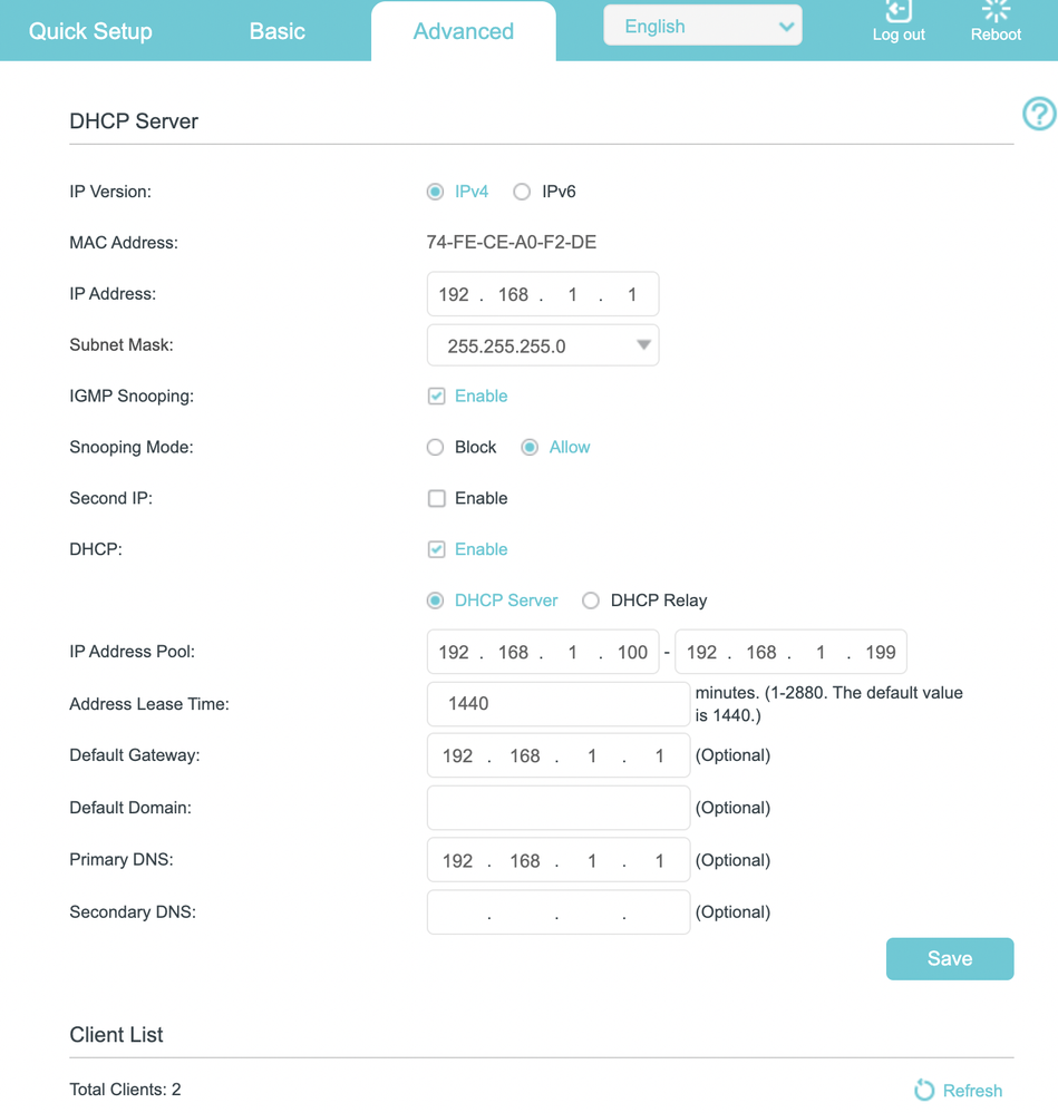

This is my LAN settings in the advanced tab so is this where I change the subnet - where it says 'subnet mask'?
and... do I disable DHCP? as @Anonymous  suggested for access mode or am I leaving that enabled?

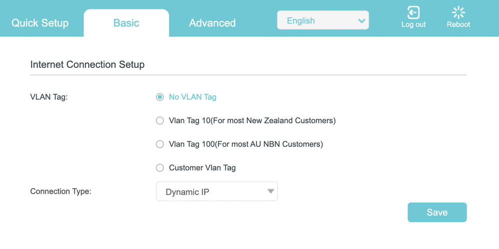

I'm also confused as to which setting (in router mode) to leave the 'Internet Connection' set to. If the hh2 is dealing with it which setting below do I select 'Dynamic IP'? or do I put it to PPPoE and put in my credentials? I'm guessing dynamic IP as pictured ?

Ok, your TP Link is using the same subnet as the hub so either you need to change the TP Link range to, say, 192.168.2.xxx or change the hub range.
The TP Link WAN connection type needs to be Static IP and then give it the address of 192.168.1.xxx (if you change the TP Link range) or 192.168.2.xxx if you change the hub range with a gateway of 192.168.1.254 (if you leave the hub as default) or 192.168.2.254 if you change the range on the hub.
