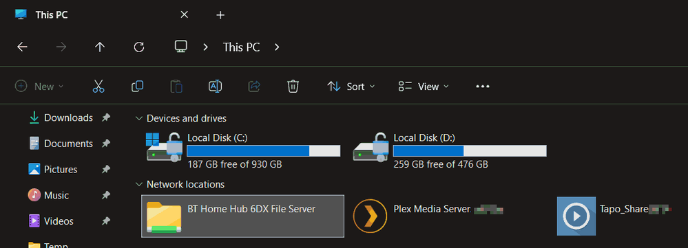

@cadogangb I'm not sure that's accurate, my SH2 has firmware v0.44.00.04123-BT updated 25-Feb-2025, and a USB drive can be accessed via the web at 192.168.50.253/usb1 (that would more commonly be 192.168.1.254/usb1) or via file explorer with the device being BT Home Hub 6DX File Server (this is a SH2!).
Try connecting to 192.168.1.254/usb1 in a browser, and if that works you should be able to add it as a file location, unless the os on your iPhone no longer allows access to such devices!

Interesting, however my SH2 has firmware v0.45.00.08028-BT updated on April 8th 2025, so I wonder if that has something to do with it?
I activated SMB1 as per another response and rebooted the Win 11 system but no luck - I also tried your two suggestions above but again no luck.
By the way I'm trying to access a memory stick.
Also when I try 192.168.1.254/usb1 it comes up with "403 forbidden" and "illegal file name"
