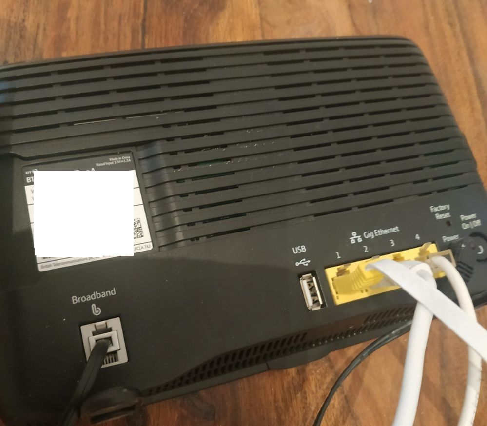

I have a BT smart Hub Typwe A - FTTC - with BT Whole Home Wifi  connected and would like to directly connect the ASUS RT-AX59U which I have just purchased to improve range and bandwidth.
Is there a way to connect the hub to the Asus and use the existing Whole Hub wifi set up using the same ssid and password as the Whole Home Wifi as I have many devices connected? Would I be using the smart hub or the Asus as the router?

I know it might be a long shot but you have posted a picture of your BT hub and it is showing the hubs SSid, wireless passkey and the Admin password. You should blank them out in the off chance that somebody nearby can use them to hack into your network.
EDIT: Just noticed the time limit that your picture can be edited has passed so I have asked a moderator to blank out the details.
