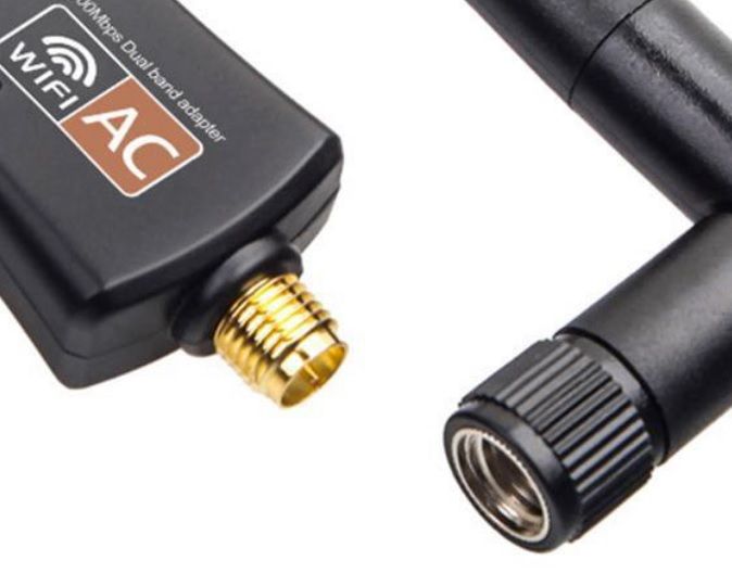

Hi,
Can anyone identify this small UHF connector on this WIFI dongle i use on the laptop. I need to extend the antenna that screws off the dongle. The manufacturer website doesnt help. Thanksuhf.jpg

I think its a F type connector

thanks for the reply. Its not an F connector. I should have provided dimensions. its a lot smaller than F type.
I think its now an RP-SMA connector

Re: What is this UHF connector on the dongle
The standard connector used for WiFi aerial is indeed SMA. But I'd probably be more inclined to use a USB extension cable to move the whole dongle away. You can get them with a little stand to hold the dongle upright.
Thanks for that, I started to think along those lines, now Ive woken up more. It makes more sense to extend the resulting " data" with a long , quality USB cable, rather than the " RF " with all the losses that entails.
My project is to capture long distance WI-FI , in a d.i.y. basis , for when we go away to places in the UK and be able to pick up BT hotspots to log into
... And to replace the stub antenna with another form of directional antenna , again DIY . - Just a project / experiment
It is indeed an SMA connector, have you considered buying a high gain antenna (e.g. 10dBi gain) to replace the standard on
