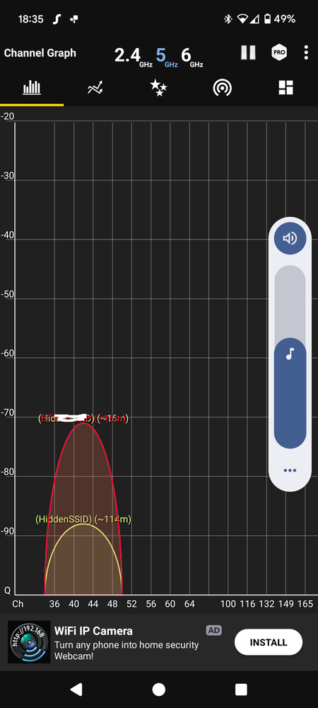

As far as I can see with a wifi analyser, the disc backhaul  follows the same channel as set on the hub for normal broadcast. However, the graph is very weird as it shows the peak at channel 42 regardless of channel selected!
The text shows CH xx (42) where xx is the selected  channel

Screenshots

I believe the 42 indicates it is bonded channels with 42 as the centre.  The meter displays looks like 160MHz to me.  Strange it should be using that, though.
