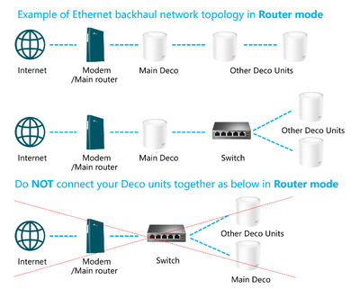

I take it I can still connect the 2nd one with a ethernet cable if I need to help with the connection?

You can normally do that with a mesh system, but I would check with the instructions, as you may have to connect another wired node, from an existing node, and not from another port on the home hub, to avoid the possibility of a loopback state.
I doubt if you need bother with an Ethernet connection provided the nodes are getting a good signal. The app should tell you that.

If anyone else is interested, this is how to set it up for ethernet connection between modules, look like a bit of rewiring is going to be needed first for me:
https://www.tp-link.com/uk/support/faq/1794/
