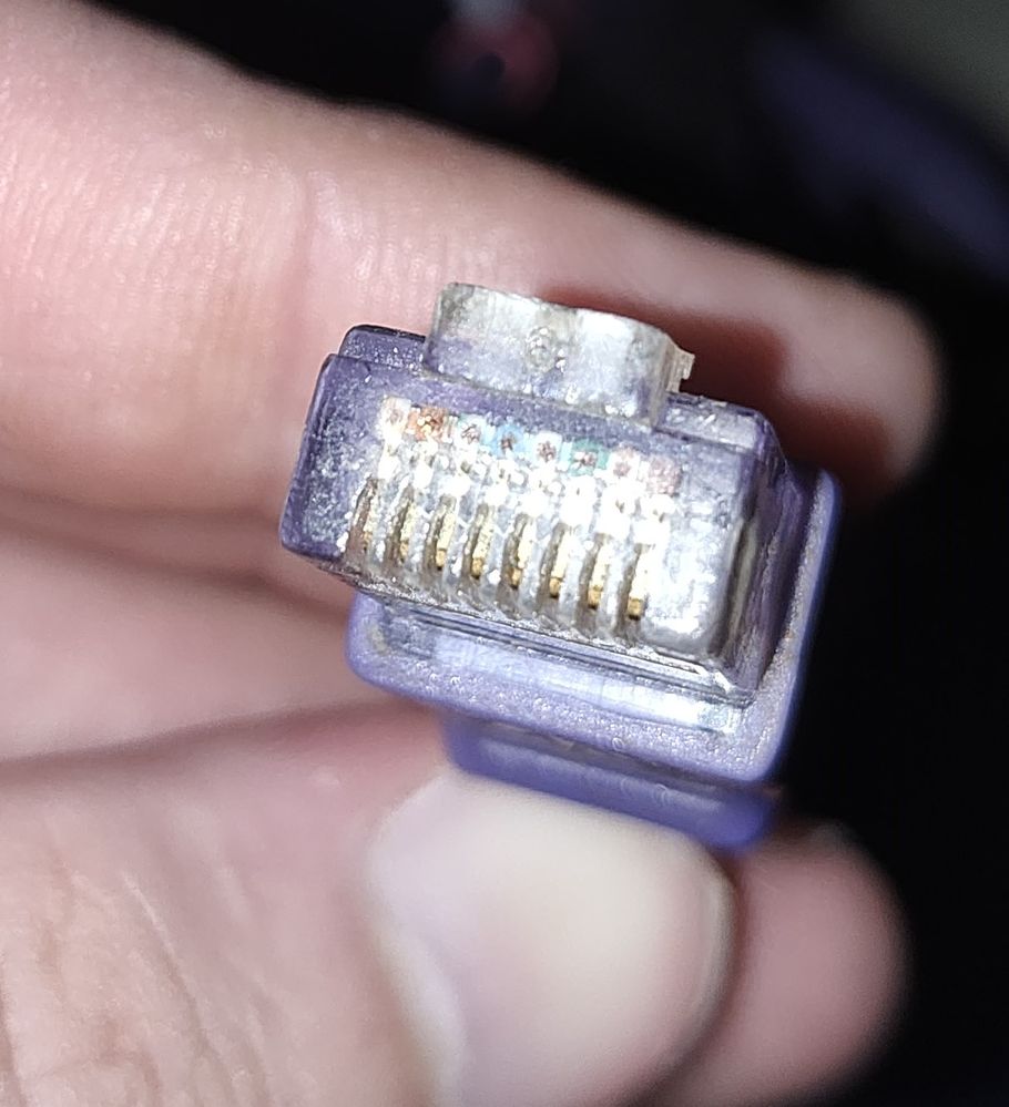

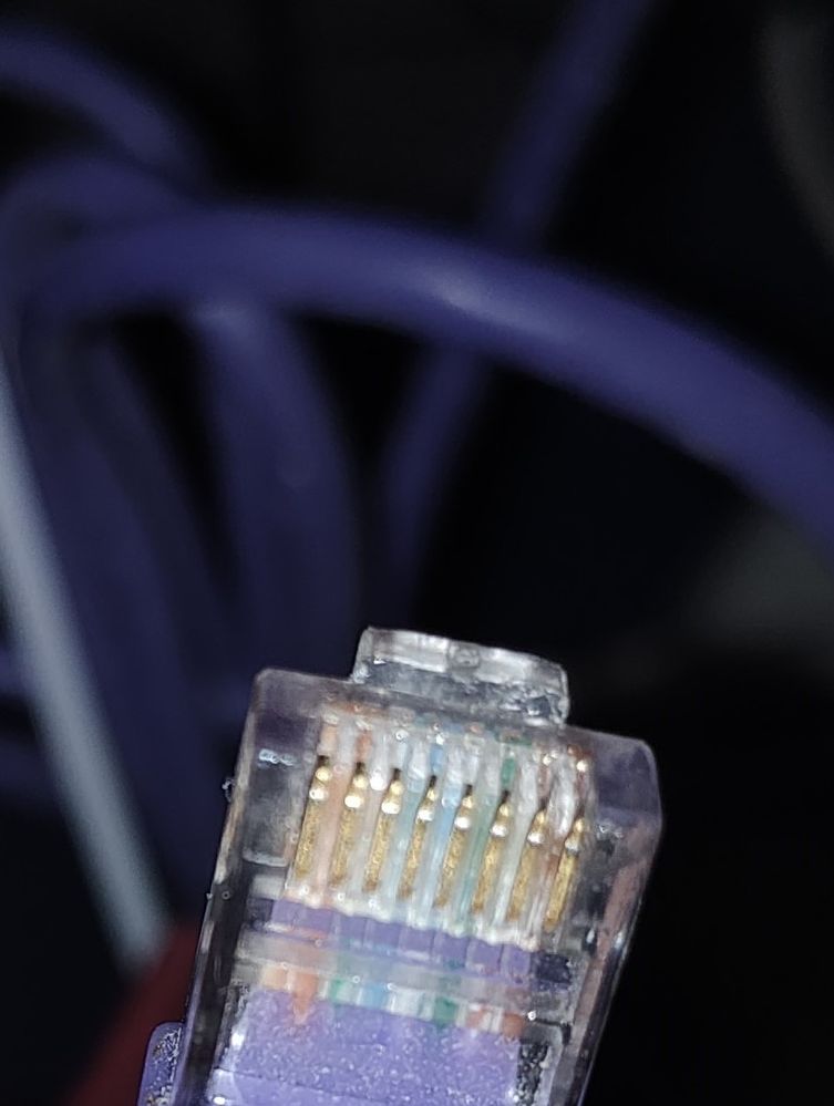

Hi, PC isn't that old it's more recent , it has 2.5gbe,   cable has been installed for many many years, through various installs  of different pcs I wanna say probably over 10 years probably more.   number on the cable reads 2835 doesn't say much info but that, possible it's faded off over the years... I should also add when I check my ethernet status it says 100mbps .. and I've checked the speed/duplex , and changing doesn't change anything... though by changing  it did manage to get around 90so it's deffo the cable.
never really noticed until full fibre.
also it was my dad that done it at the time, I assume it's a cable we had laying around and he just used it.
I don't know if these photos help but i've included them.IMG_20240625_002551428.jpgIMG_20240625_002558941.jpg
2,392 Views
Message 7 of 7
Re: wifi gives me more speed than ethernet on my pc.
Need to check the cables insulation and what’s written on it and if it’s cat5 or cat5e.
I did a giant cat5e run before and it took 4 attempts to terminate it to get 1Gbit, nowadays I just use Passthrough connections as it makes my success rate almost 100%.
From what you say it’s probably the cable, could be a break somewhere in one of the 8 wires, only takes one and it’s 100Mbps for you. That’s what I say get an Ethernet tester to make sure the cable is terminated correctly and you have the correct continuity on both ends in the right order.
