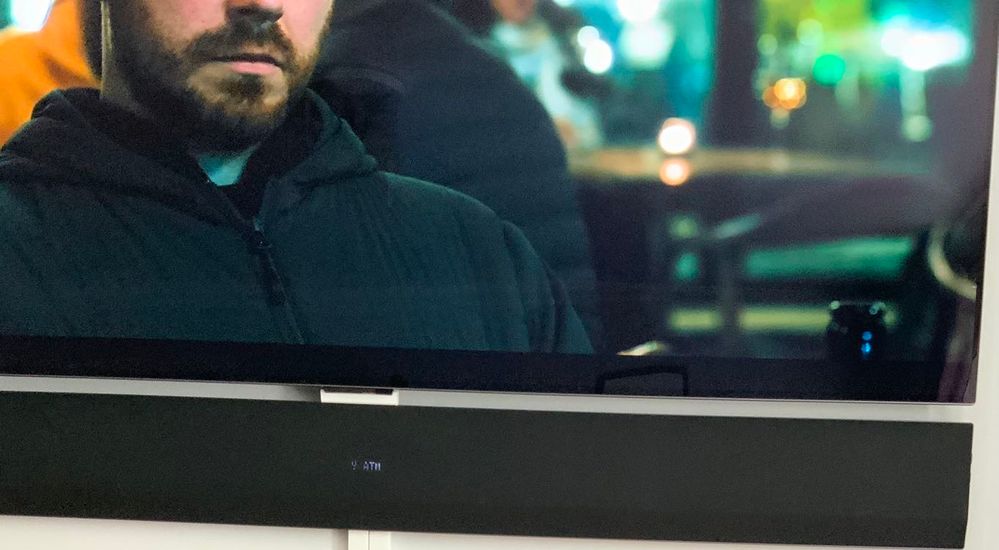

@NigelB72
I just put on the Apple TV app on my Box Mini should be same as Box Pro here), went to Slow Horses S4, E6, which is shown as having Dolby Atmos, played it, and my soundbar confirms the Atmos (I press Info, it just scrolls DOLBY ATMOS and goes back to ‘eARC’, so kind of hard to snapshot, but you can see Y ATM going by on the soundbar, at bottom):-
So the Box can do the advertised Dolby Atmos; your question now is why there is no Dolby Atmos where you expect it, maybe because what you are playing doesn’t offer it, or the subscription you have it on doesn’t run to it?
Can you try my above recipe, see what you get? Hopefully, we are all the lucky beneficiaries of a free Apple subscription at the moment.

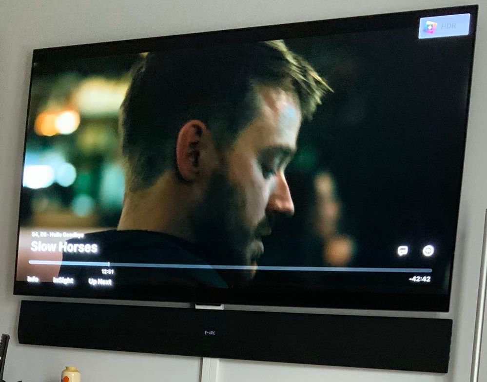

@Midnight_Voice are you getting UHD HDR on AppleTV via the Pro Box?
There was an issue on Sky Stream where AppleTV was defaulting to Dolby Vision and if it couldn't detect a compatible device, it'd fall back to HD and no Atmos rather than outputting HDR10 with Atmos. It was picked up pretty quickly and a fix was issued which I imagine was an update to the app.

@NigelB72
Box Mini here, but yes, you can see the momentary HDR indicator top right in this screenshot:-
