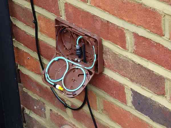

Wall Box with bare outer cable

Opened up previous work to start the fusing to internal modem
Took the coating off the fibre on both sides
Special tool to cut the fibre with perfect edge
15 Seconds and they are fused, 0.0dB attenuation, best the Engineer had seen for FTTP
Fuse another sheath over the fused fibres for protection
And Bob's your Auntie
