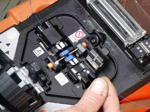

Takes the coating off both sides so they can be fused
Special tool to give a true edge to each fibre
Fibre from road and fibre to inside of house ready to fuse
Fused in 15 seconds, 0.03dB attenuation on complete link to exchange, perfect
