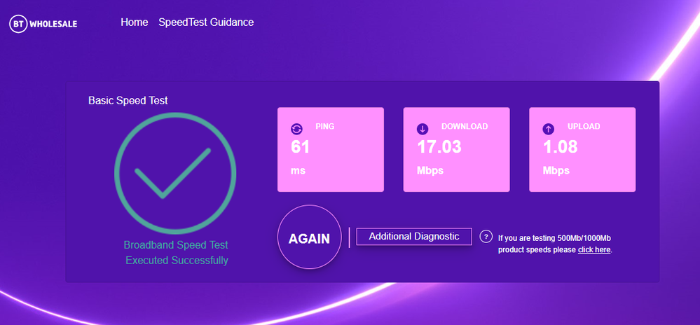

@Anonymous  I connected the new hub as soon as I got it and the engineer did all the tests on the new hub.  I have returned the old one already. ALL of the tests I have done have been done with my laptop on a wired connection.
@imjolly I had a video conversation on Facebook last night with a friend and the connection was very very good.  Not perfect but a lot better!  This afternoon however I tried to watch iplayer and it just wouldn't connect long enough to watch it and I had to connect to my neighbour's wifi!
The first photo is of the speedtest WITHOUT the phone as requested above.  The second is WITH the phone.  Both done on my laptop with an ethernet connection.  Both were done around 17.30 today.  Much better aren't they!
MINUS PHONEMINUS PHONEPLUS PHONEPLUS PHONE

@judymeg
These connection results look far better and nearer your actual connection speed
