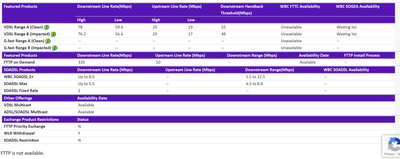

Thanks for your response, It more or less confirms what Im thinking. This is the result from the address check

60 to 80Mb would be available if the FTTC ‘cabinet’ wasn’t at capacity ( its showing ‘waiting list’ )  so ADSL2 is the only current option, and the predicted speed for that is up to 8Mb .
FTTC cabinet capacity is dynamic, as people join and leave the service , the cab will vary between showing ‘available’ and ‘waiting list’ , so you could keep an eye on the availability and order FTTC if the cabinet status changes to available , otherwise it’s ADSL2 and 8Mb , only you can decide if that’s OK , FWIW , when I was on 3Mb ADSL ( 5Km line length ) it was OK for most things , but obviously is pretty slow by today standards.
The theoretical maximum for ADSL2+ is 24Mb , but that’s not really achievable even with the shortest possible line , 17Mb is what most providers state as an average speed ( upto 17Mb ) but as your  predicted speed is much lower  .
ADSL is a rate adaptive system , longer lines slow speeds , your line length gives a prediction of 8Mb , that’s probably OK for most things apart from 4K video streams ( HD consumes around 5Mb )
