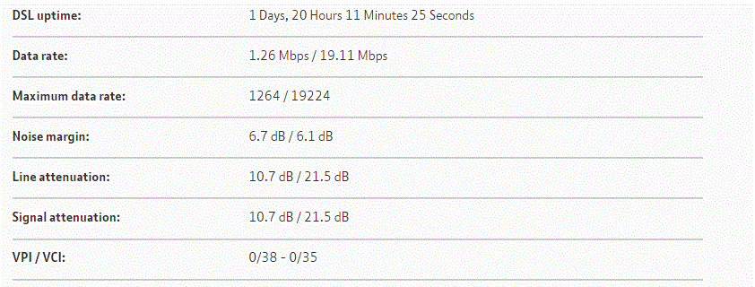

Here's a picture of my stats taken just now. I see that my Hub restarted unknowingly over a day ago and mine does this about every 10 to 20 days I suppose.
