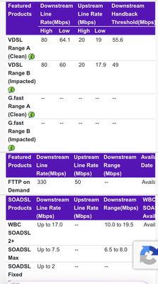

All FTTC cabinets deliver 80Mb on lines short enough to get that , FTTC is rate adaptive, that means the speed at any particular location is a result of the distance from the cabinet and the quality of the copper pair .
If you once got 68Mb and now dont , that suggests a fault on the copper pair has impacted the speed , and if unresolved the minimum speed guarantee can be reduced to reflect the real world speed that cable pair is delivering, resolve the fault the speed improves and eventually the minimum speed guarantee follows, the problem is once the MSG is reduced, reporting a fault is judged against the new minimum and if the speed is above the reduced minimum it’s difficult to get a fault raised simply using ‘speed’ as the fault.

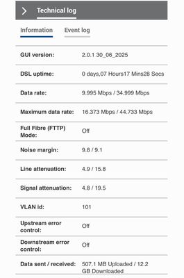

Post your router connection statistics, that will show the max attainable speed and your current sync speed , giving an indication if your line has issues .

Re: Router identification
225 Views
Message 19 of 23
Line attention suggests a  relatively short  line and therefore a speed closer to 70Mb , so I’d suspect a problem ( that’s assuming your router is connected to the master socket , preferably in the test socket to remove any chance the problem is within your address ) , log into your account ( My BT ) and perform a line test , if a defect is detected it may auto report the line for you  because if you call BT  , saying your speed is lower than expected/normal that hits the problem that this defect has existed long enough for the actual real time line data to override any mathematical estimate, so doesn’t look ‘slow’ , try putting a very near address into here and check the speed estimate for that address , does that show 70Mb+ ?
https://www.broadbandchecker.btwholesale.com/#/ADSL/AddressHome
If an automatic fault isn’t raised by testing your own connection via My BT , you need to be creative when manually reporting a problem , or hope to get an understanding representative that doesn’t just use the MSG to dismiss your concerns, but first , if not currently in the master socket test port , move your router to it and check your statistics again.
