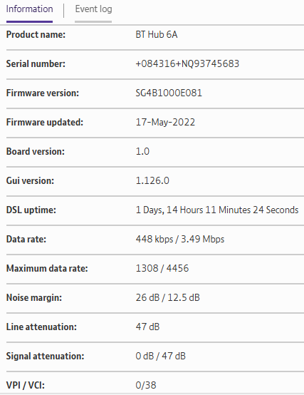

are you able to post stats from hub - advanced settings then technical log information
you have hh6/SH1 and the newer SH2 is more suited to FTTC or FTTP connections

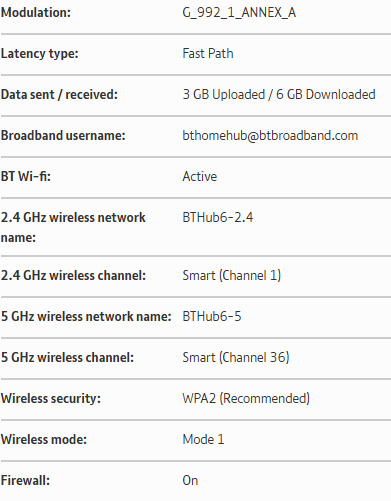

thanks
from stats the increase in down speed due to distance from exchange will no be great moving to adsl2 but it will make difference to up speed probably 2x
I note you split the 2.4/5ghz networks but you cannot do that with the newer SH2
you need to phone CS 03301234150 and get them to move you to adsl2
