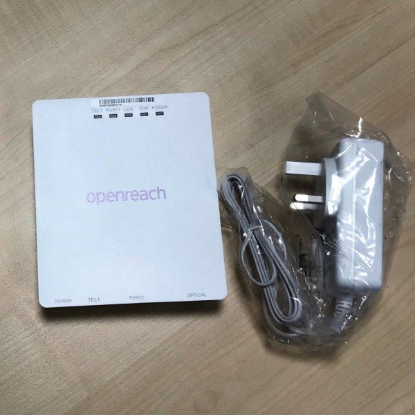

That ONT image appears to have a Tel port.  That's different to the previous reply.  Who's right?

Ref to the ONT having a TELE Port, that is for Openreaches Fibre Voice Access Service only, which they are stopping very soon. They are using up their existing stock of Huawei ONT’s that have a TELE Port but the new ones won’t have one and the Nokia ONT’s don’t have one at all.

I don't have much to have to the other comments here which completely mirror my recent experience, but I have to say that I'm on my third FTTP install since 2010(ish), and I've always been really impressed with the way Openreach have thoughtfully and logically evolved their install process over time (my latest install in July has the ONT as pictured in the image). My engineer was open to discussion about where the fibre cable entered, but in the end I elected to have the ONT at the normal point of entry for my previous copper cables and then run ethernet cables internally between the ONT and my BT SmartHub which was placed for best WiFi signal, (also, my thinking was much like you yours, I didn't want 20 feet of easily vandalised fibre cable running down the outside of my house, especially with my priceless Vauxhall Viva parked on the drive with its keys in the dish on the dresser right by the front door 🙂
