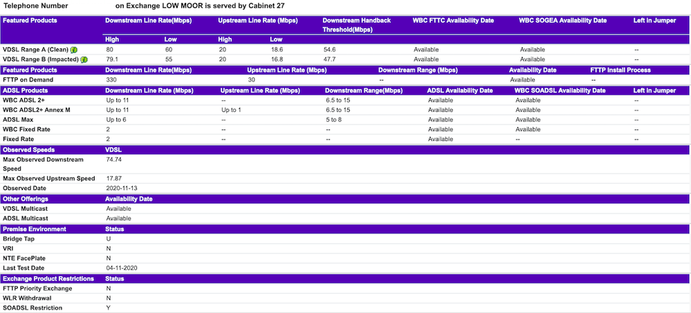

Hi,
I currently get just shy of 80mb. My cabinet is around 100m away. I have ran searches on several properties around me and they can all get higher end GFast speeds. This includes all houses on my street. My next door neighbour is estimated to get GFast at 257, but they don't actually have broadband of any type so cannot confirm this.
I have checked this on www.broadbandchecker.btwholesale.com using mine and my neighbours telephone numbers for an accurate result. I've spent some time checking on properties that surround me using address only as I don't have their landline numbers. It appears that it is literally just my property that cannot get GFast. I am on a small street of four houses who can all get it, all of the houses surrounding me on nieghbouring roads can also get it. These are connected on Exchange LOW MOOR served by Cabinet 27.
Does anyone know what the reason for this might be? I know this type of question has been asked multiple times, but I've not as yet seen any answers other than explanations of FTTC / GFast, FTTP, FTTPoD etc.
My specific question is why is my house seemingly in or near the centre of dozens of properties that can get GFast while I can't?
Given my limited knowledge I can only assume it must be down to things like an error in the OpenReach database against my landline/address, issues with the cable to my property alone, configuration in the cab relating to my connection.
At the end of the day I am unable to get faster speeds for the time being, but it would be really useful if someone was able to shed any light on this. A faster connection would be extremely useful with working from home and the nature of my job (regular large file transfers!).
Thanks 😊
My stats:

Re: Another GFast question
The fact you're not getting near your top speed with VDSL is exactly why G.Fast isn't available to you. Whether this is a line issue or distance, or a bit of both is info I can only guess about. When I saw your VDSL estimates and noticed the low end and hand backs are relatively low I suspected it, and further down the max sync speed of ~75MBit is further evidence. It's pretty rare to see a line that isn't almost perfect for VDSL getting a decent G.Fast connection.
G.Fast uses higher frequencies than VDSL so signal attenuation over the same piece of copper is much higher and thus requires a more perfect line to work. As Openreach wish to ensure that anyone taking up a G.Fast service has a trouble free experience they don't even bother showing availability if the estimates for an individual line drop below a certain point - I've a feeling this is a hand back of 100MBit but don't quote me on that.
So I'd suggest try to get the fault on your existing service fixed and then wait a few weeks for the openreach line checker to update and maybe you might get G.Fast showing. Beware though that if you're still towards the edge of coverage due to distance then often while you may get a higher download speed, the upload speed could be less than you may have now.
By the way, post the screenshot of your neighbours estimate of 257MBit. There's a high difference between that as a Max and a clean line or as a hand back threshold on an impacted line for example in us judging what's going on.
