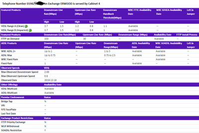

enter your phone number and post results  remember to delete number   https://www.broadbandchecker.btwholesale.com/#/ADSL

You would be better on ADSL, as its shown as available.
It comes from the exchange, so the fact that your main cabinet is linked to a fibre cabinet, has no bearing on that.
The problem is that it seems to be impossible to order an ADSL connection, if there is FTTC available, even though the connection may be worse.
It should be possible to override the order system, and allow an ADSL regrade to take place, otherwise there is nothing you can do.
You are well below the minimum USO speed, so BT should off a 4G mobile connection, provided you are in a 4G coverage area.

How is your phone line working then, as that comes from the exchange not the cabinet? There is no exchange equipment to give dial tone, in the cabinet.
The availability checker says ADSL is available, but upload speed is likely to be very poor.
I think you have got the best connection you are ever going to get, unless Openreach install FTTP.

from dslchecker your speeds are better on fibre than on adsl but not by much.  Speeds are within expecked range but you are so far from street cab you are not going to get any better. You appear to be on fibre 2 and would be better on the essential package and save some money
