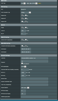

I assume that your DSL settings look like mine and you're not using Dual Wan at all:-

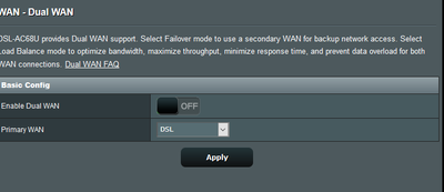

Also the Dual Wan page should look like this:-

I used the wizard  to set up my router, should I have done it manually ?
my wan internet settings seem the be the same as yours but I am missing PPP MRU setting and I have an automatic DNS.
I am not using dual WAN and my settings look the same as yours on that page
