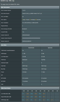

However, I see in the router's diagnostics that my downstream "data rate" doesn't come close to the "max rate" figure, which I assume is my sync speed? Data rate is 73% of max rate.
 DownUp
Data Rate52567 kbps19272 kbps
Max Rate72112 kbps19273 kbps

Is it possible that someone can check my line for an issue, which might avoid a visit? BTW, I had to reboot the new router a few times to get it working - it reported sync & an internet connection but browser could not display pages. It worked OK after I set MTU to 1400 & rebooted my PC - I suspect it was the reboot that picked up a new DHCP config. MTU is now reset to 1492.

Downstream SNR is 3.1dB.

From what you have posted you do not have a sync speed of 72mb but currently your sync/connection speed is about 51/52mb from your router stats and the dslchecker results  obviously as you connection speed is about 52mb then your download speed will be less probably 42/46mb by ethernet   your connection time is only 2hrs is that manual reset or router dropping connection?

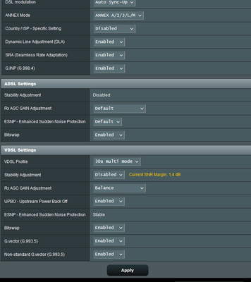

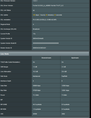

@MP99
How do your settings compare to mine:-

Using this Asus router is highly likely to be part of the problem for sure. This model uses a Mediatek chipset which is known to have significant compatibility and performance issues, and I believe Openreach disable g.inp when detecting them being used which will reduce performance. Your stats show Interleaving is now in use which will generate an artificially high 'attainable' rate.

Can't really agree with you there.
If I switch to a SmartHub my download speed increases slightly but my upload decreases noticeably . These are my stats currently:-
I've only recently been switched to Interleave but my ping is 7ms generally but I don't game so not bothered anyway.
You'll notice from my stats & those of @MP99 that the connection is showing G.INP as activated.
5,709 Views

What would the 72112 kbps figure be if it's not the sync speed?
It is not your actual sync speed, it is the predicted maximum speed your line is capable of. The 52M figure is your actual sync speed.
