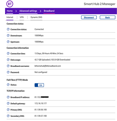

If disconnect all our Wifi devices (devices are all new with Wifi802.11AC) and simpIy directly connect the MacBook Pro (Gb port) to one of the ethernet ports on the SH2 only get 150 - 250Mbps (compared to the OpenReach modems demonstrated values of 900Mbps+. As you can see from my screenshot the SH2 status page says Downstream 1000Mbps and Upstream 1000Mbps with Full Fibre mode set to ON.
It seems we have a very stable FTTP connection and kudos to OpenReach / BT  team here for delivering a great service.
MODS, I wonder if you could give your thoughts here? Do you think the SH2 is faulty or just has a wrong "profile" installed? Enclose screenshot of our SH2 broadband status page (with IP address blanked out). I've swapped out the SH2 > OpenReach fibre modem ethernet cables several times with tested CAT 6 / 8 but it makes no difference to the speed from the SH2. As I said a PPoE connection direct to the OpenReach modem gives an amazing and very stable speed, just not through the SH2!

The hub will always show connected at 1000Mbps as it is just a GbE link to the ONT.
