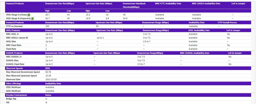

From dslchecker results you had 63/13 mb connection on 29/10 but you now have 55/10mb suggesting you were on fibre 2 but have now downgraded to fibre 1 maybe to save money. Did  you make the change or is there an error.
Stats don't show connection time.
Did you try using test socket with a filter to see if that helps stability
Was quiet line test absolutely silent?

Hi, thanks for the reply. I've always been fibre 1, never got above 55mb so that sounds like an error! Line test not absolute quiet but I'm using a cordless phone so heard what sounded like a normal low, dull hum sound (no cordless I'm afraid).
I tested once for a couple of days with the test socket and filter, had one drop out in that time so on a par with now.
