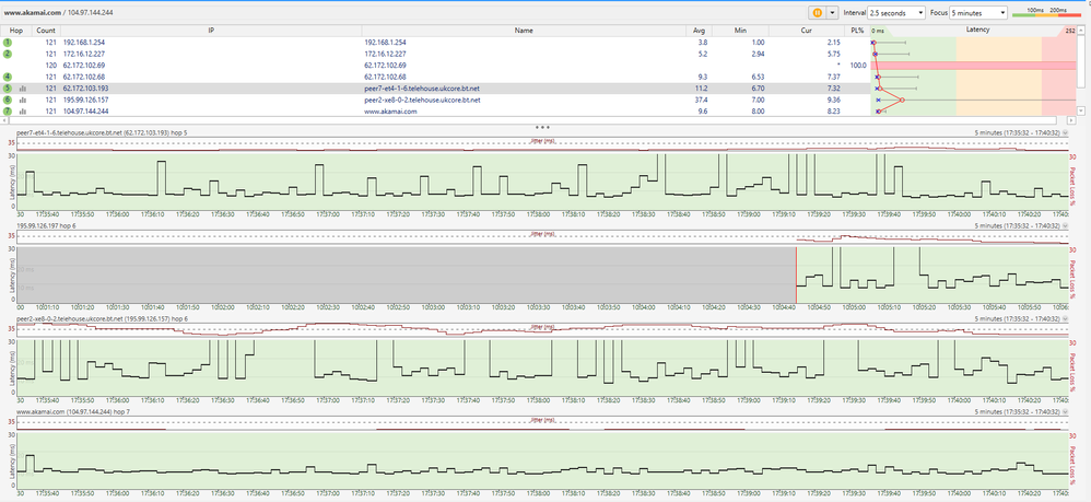

I am not sure where I can go to get this issue fixed but the subject just about explains my issue. My boys have been complaining about lag in their online gaming and this is really affecting play. You can see by the in play stats that latency/jitter and sometimes packet loss is an issue. I have run ping plotter and can see very high latency as well as high jitter for peer2-xe8-0-2.telehouse.ukcore.bt.net.

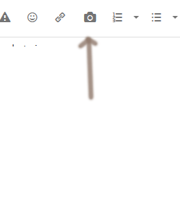

Do a screenshot and use the photo icon.

Ah yes I see now!
Here you go.

OK so a better screen capture!

OK, you are not going to like this but that shows 0 packet loss.
As I thought when you first posted you don't understand how to read a tracert. Not getting at you, there's a lot that don't.
When looking at tracert's or pingplotter results you start at the destination. If there is no packet loss there then anything inbetween is immaterial. How could the packets have got there if they were lost on the way?
The fact that one or more hops may show packet loss just means that the routers are doing what they are supposed to do and treating the forwarding of packets as a priority and not responding to ICMP requests or they are specifically configured not to.
Latency looks good too.

Yes I know that shows 0 packet loss and the packet loss was in a different sample but that appears to of cleared itself now.
So you think latency spiking at 300+ ms is good, it isn't so I'm not sure why you think it is?
This is also evident in the games that are reporting high latency and also packet loss. So are you saying they are wrong as well!?
When gaming you should be shooting for <30ms otherwise lag is evident in the game play. Granted the screen shot I provided you shows about 32ms but yesterday it was over 50ms which is not good. Also I dont see the huge spikes at any other hops so I would probably disagree with you on this. Something is not right.
