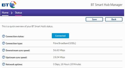

Recently had my internet 'fixed'...between a replacement hub and a new line from the box on my house down to the master socket....I originally had speeds of 70mb+ down and 12/13mb up.  This suddenly went down overnight to 42-46mb down, 12/13mb up, and regularly drops/disconnected.
Firstly I was told no issue on line, and had a replacement router.  This somehow made things worse, speeds went to 37mb down....rang BT again, spoke to another fella who said I must have issues on the line.  Nice chap came down, replaced the line into the house...messed about with the master socket and said my speeds should return to normal.  Since then my speed has gone back up to 56mb down and 18mb up, nowhere close to where it was but better I guess...but when I do a quiet line test, it did seem noisier than before 😐.  Will my original speed ever return? Or will the constant disconnects and  potentially a worse hub hamstring it forever!!
Also, as shown in picture below...on my router it now says Connection Type: Fibre Broadband (VDSL), now this always use to say BT Infinity 2, 3, 4   etc.  Why has this suddenly happened? Is something not right?  Any ideas be great! 🙂

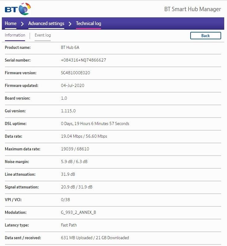

in order for the forum members to help please can you post the stats from your router (if hub enter 192.168.1.254 in your browser) if HH6/SH2 then advanced settings then technical log information .
enter your phone number and post results  remember to delete number

lineStats.jpg@pippincp Thanks for that, will chase up the noisy line issue. Wasn't terrible, but definitely not quiet.

@pippincp
No I read the bit about some line noise and I wanted to see how bad it was affecting the connection by comparing expected range with the hub stats.  It will also help when noise is fixed for comparison

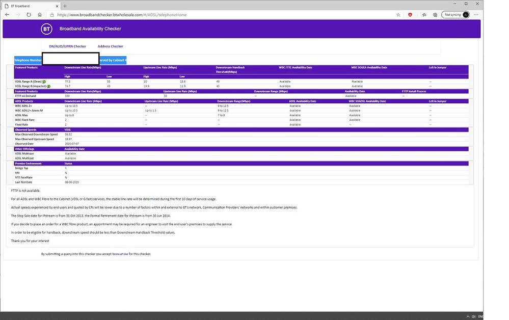

@Dazz0r77  You blanked out the exchange so we can't tell what type of cab you are on and if G.INP would be available.

Exchange GILWERN is served by Cabinet 4... DOH!
