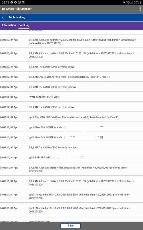

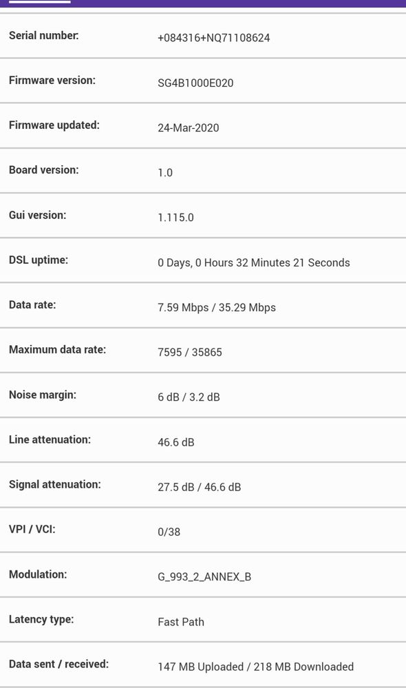

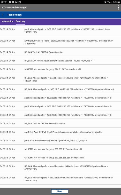

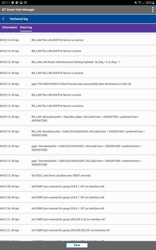

Hi everyone, for a little while now my Router will just randomly disconnect for no reason, flash pink/purple for a few seconds, then flash orange, then steady orange, then back to blue. This happens in about 30 seconds or so, and is random as to when it happens and with no explantion. I looked and took some screenshots of my techinical log at the time it happened, so if someone who has a bit more knowlegde could look and find the cause for the drop outs in my log I would be very greatful as I dont fully understand it all. The disconnect happened at around 4:00am-4:10am (as when I looked it showed my DSL uptime to be only 30 or so minutes as I did not check my log info straight after it disconnected. Though the disconnect definatly happened around the time stated above. Please could someone look through and give me some more info and what I might need to do to get it fixed its really annoying. Is it my router that is faulty? The line itself etc? I did edit over my IP address so that is not shown.
