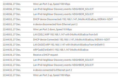

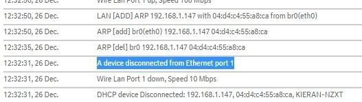

I have no idea about the line, I think the phone line is BT but I don't have a corded phone. Anyway the rebooting went away for 3 days or so but today it has happened 8 or 9 times throughout. I've found it in the log
It's been the same message each time, I've swapped the cable to the router the port it was plugged into on the router and restarted the router but it's doing the same thing.
I've raised a fault with BT to see what they say

No worries. I was connected directly to the hub, but I connected an old TP-Link switch last night as I read it could be due too something called Ethernet link pulse timing errors. So it's now hub, into switch into My PC. I can't see any way to attach the log.
What is it you want to see?
