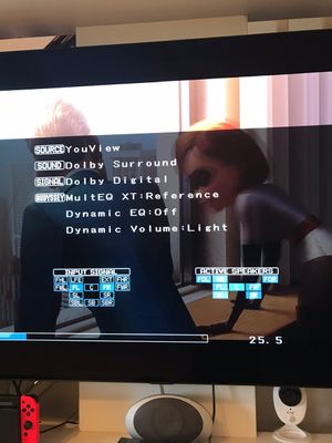

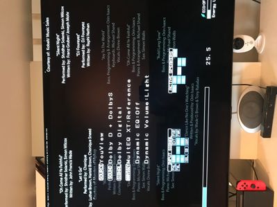

@Will168 For a Denon with the T4000 even when set to surround the output matched the correct format. This can be seen in the picture below showing that when BBC1 HD was just a stereo signal the active speakers for the input signal were just two (I have also included a picture showing a DD signal - as opposed to a DD+ signal which is all the pro box outputs in surround mode). This is how it should work.
The T4000 will output the correct signal, the broadcast channels can output a Dolby Digital 2.0 or 5.1 depending on the programme so this should be output exactly as broadcast even if on surround, people can then decide how they want to deal with that (leave as stereo, make a pseudo surround signal  etc). The pro box just mixes everything to a DD+ 5.1 output no matter what the broadcast when in surround mode and this causes all sorts of different mix through the speakers.
