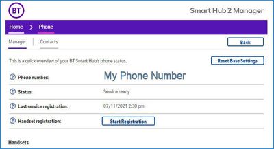

Message 5 of 21
Re: BT analogue phone service not recognised, etc.
Hi @Les-Gibson  thank you for the link. My phone number is on the top line. Do not know how to get BT analogue phone to work again. Digital Voice is just too expensive. When ordering, made it clear, no BT Digital Voice (retain analogue phone). Kind regards.

Message 6 of 21
@crimsom
Plug your analogue phone into the phone socket on the back of the Smart Hub 2, and it should work as normal, that is an analogue port. Its shown in green below. There is no need to use any BT Digital handsets.

Message 8 of 21
The fact that your number is showing on the home hub, means that your phone service is now carried over Digital Voice. Your old copper landline would now be a stopped line.
