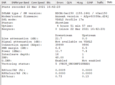

Hi
DSLStats shows that G.INP is already enabled downstream so presumably it's just a matter of waiting?

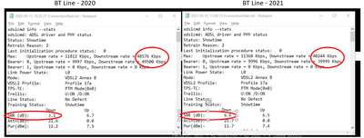

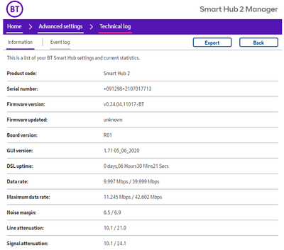

Ok so a couple of days later (and also reverting to the Smart Hub 2 to ensure network is fully 'compliant') and the speeds are still stuck at the 39999kbps cap of the WBC FTTC 40/10 service.
Now I'm back on a BT line if I check the DSL checker it shows the latest speedtest I did before my move from BT to TalkTalk.  The line then was supporting 47Mbps down / 11Mbps upload
Will raise a billing support issue - unfortunately the fault reporting process refuses to acknowledge an issue with the line as the minimum speed achieved is above the handback threshold.

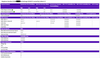

Fibre 1 service was connected on Monday 22nd March.  After the switch I noticed that the max permitted speed was still capped at 39999kbps inline with the WBC FTTC 40/10 package I was on with my previous provider.
Have monitored over the last two days and the line speed is not rising above the 40Mbps cap even though there's plenty of range left on the line to stretch into the high 40Mbps range.
I only chose the Fibre 1 over the Fibre Essentials package when switching to BT as I knew the line would handle an over 40Mbps connection.  My current phone line results from www.broadbroadchecker.btwholesale.com still shows the speedtest I achieved on BT immediately prior to my switch to another provider back in March 2020.
Please can someone look into the commissioning setup vs the agreed plan to ensure that the line is commissioned for the service being paid for.
