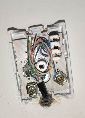

Hi  everyone!
We recently moved into a new home and registered our broadband with BT. In one of our bedrooms there's an unusual BT box by the wall. I unscrewed to see what could it be but I genuinely never seen something like this? (See pictures attached)
Is anyone able to shed a light on this?

Is your BT Broadband working properly, as that is just a junction box, probably joining the external incoming cable, to the internal wiring, usually if you phone line comes from a pole.

Here is your picture, so all can see it.

My broadband is working properly. I was just wondering if I could use this box (maybe calling someone to fit a plug?) to have an ethernet connection in my bedroom as it's currently used as a working from home office... 🙂
I have the feeling this might be the cable that is coming from downstairs (this box looks positioned in line with my downstairs internet plug)

No, you would not be able to use that cable. I suspect its the main incoming line. Does your phone line come from a pole?

I think you will just have to trace the cable. Its jus a bit odd that it looks like black external cable coming in.

I think that may be an old ‘Redcare’ block terminal 92a, BT Redcare being a monitored alarm system that utilised the phone line , it was/is an ‘alarm by carrier’ system , not a dial up alarm, so  if the line was ‘cut’ the alarm was still raised ( as well as other types of activation ) , dialup alarms easily disabled just by cutting the line it was connected to , ( before mobiles )  presumably the OP’s property once had this type of alarm system

It does say BT 92a on the block terminal which iniltous correctly identified as as Redcar Block Terminal however other than a different cover this is identical to a BT80A. This is used to convert an incoming Dropwire from a pole to an internal type cable.
The Dropwire terminates under the screws and the internal cable in the IDC.
