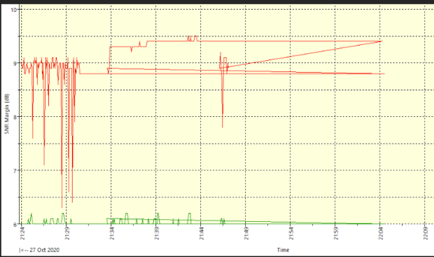

In september I replaced the modem with an HG612 to check stats and it was quite clear there was REIN interference - SNRM was jumping all over the place (see first pic).
I identified some powerline ethernet adaptors as a possible cause and removed them and the line settled.
An Open Reach engineer in November while fitting a new broadband line identified water in some of the OR junctions and cleaned it out - as this was not on my line, no line reset performed.
Since then the line has been rock solid with little to no SNRM fluctuation, ES per day less than 2 (0.06/hr) however the line remains banded at 25,000 kbps.
I get the feeling DLM has acted over the last year in response to noise and possible water in the circuit.
However now things appear to have cleared and stats have been stable for a while I'd like to get this banding removed and go back to 3DB SNRM and the speed the line should achieve.
Line stats prior to fix.
Line stats with unstable SNRLine stats with unstable SNR

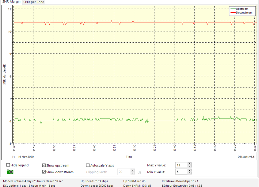

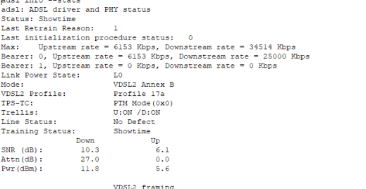

Stats currently.
Line stats nowLine stats now
